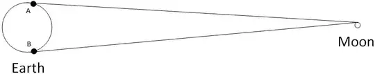

During the classical and early Hellenistic period (until 200 BC) Greeks did not use any positional system, they had their own which was decimal but not positional. The units from 1 to 9 are assigned to the first nine letters of the archaic Greek alphabet from $\alpha$ to $\theta$. Each multiple of ten from 10 to 90 was assigned its own separate letter from the next nine letters from $\iota$ to ϙ. And so on, see Greek numerals. This worked fine for practical and even some scientific calculations. In the 3rd century BC Eratosthenes and Aristarchus, Archimedes's contemporaries, did calculations for estimating the circumference of the Earth and distances to the Moon and the Sun without the benefit of not only zero but even of a positional system.
