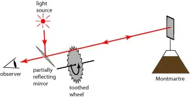

This image:
fizeau speed of light arrangement

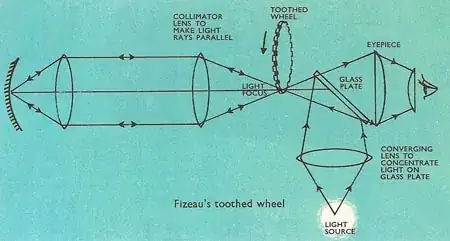

is the most explicit one I've found for the experimental arrangement. Here's another that is more schematic, but illustrates the basic idea:
Now on to your specific questions. The light passes through the gaps between the teeth; it is not refracted. Pulses of light hit the mirror and are reflected back.
In the experiment, the speed of the wheel is gradually increased. Initially the light making it back through the toothed wheel gets darker and darker. That's because the light pulses arrive in time to hit the teeth instead of the gaps between. As the speed of the wheel is increased, the reflected light starts to get brighter, reaching a maximum when the timing is perfect: a pulse leaves the gap on the way to the mirror, reflects, and makes it back just in time to pass through the next gap. In principle, as the wheel speed is increased, the experimenter should see the reflected light getting darker, then lighter, then darker, etc. Thus, the second brightening should occur when the returning pulse of light goes through two gaps past the original gap.
