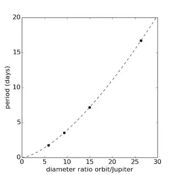

I made a plot of the period of the four satellites versus their orbit size, as a ratio to the diameter of Jupiter at the equator. That would have been easier to sketch/estimate than absolute size.
Is there any record of a plot or graph somewhat like this - to visualize even qualitatively what kind of relationship there was?
Today one would make a log-log plot and immediately "discover" the 3/2 slope, but logarithms weren't available yet.

  • Thank you - that's a pretty clear answer! Also thanks for the linked question. At first I thought mine was a duplicate, but actually I'm primarily interested in just the "3/2 power law" behavior. As I mentioned in my comment here I'm surprised that Kepler didn't see the relationship much sooner by watching Jupiter's Galilean satellites! – uhoh Mar 25 '16 at 23:59
Kepler's third law was discovered on the basis of comparison of periods and distances of the planets. This was in 1619. Only in 1621 Kepler noticed that Galileo moons of Jupiter also satisfy this law. This fact was later used by Galileo as an argument in favor of Copernican system.
