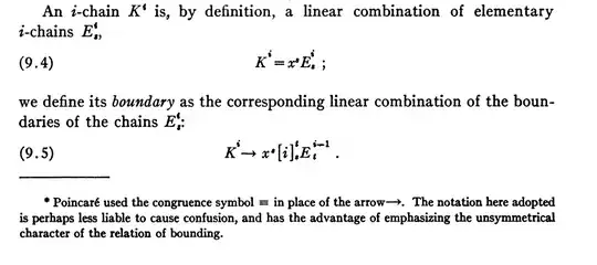

  • Perhaps this is incorrect, but Alexander, in Combinatorial analysis situs, uses the word chains as if it is an established term and he is modifying it to work with a different sort of chain. "We then give a short account of the classical theory of connectivity and of a modified form of the theory where we operate with chains reduced modulo $\pi$." – Catherine Ray Aug 25 '15 at 17:43
  • @CatherineRay You're right he sounds that way, but it can also mean the word first got "established" in Princeton conversations before the paper -- that would be how Lefschetz, who was there, can write what he does. – Francois Ziegler Aug 25 '15 at 17:53
  • I agree about the ambiguity there. I was unable to post a picture in this comment thread, so please see the picture I have appended to my answer below. – Catherine Ray Aug 25 '15 at 17:58

Also note, Alexander's definition of the term chain (page 301 of Combinatorial Analysis Situs) cites Poincare's formula for describing the cell structure of a manifold in terms of an incidence matrix.
"In his first long paper on topology Poincare (1895) continued to explore the Betti numbers. He set up machinery for computing them by assuming that each manifold has a decomposition into cells homeomorphic to simplices, reading off linear equations he called homologies, and computing the Betti numbers by linear algebra."

  • I agree that the introduction if the word chain to denote a linear combination of simplicies is motivated in order to both define manifolds and to calculate their betti numbers. I'd appreciate it if you would explain how Alexander is defining a concept that is different from Poincare's definition of chain. – Catherine Ray Aug 25 '15 at 19:38
  • I agree that from the point of algebraic topology those two concepts are essentially identical. But must of the stuff I do is geometric measure theory, where both also occur and where a chain and a manifold are different objects, since one is flat and has only piecewise differentiable structure, while the other is curved and smooth. Of course even there, they are closely related, both being a special case of integer rectifiable currents. Also the definition of boundary for a chain as the sum of boundaries of the parts does not work for Poincaré's overlapping pieces. – mlk Aug 25 '15 at 19:57
