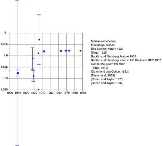

If anyone's still reading this thread, here's a few more data points that appear to back Feynmann's interpretation.
Erik Bäcklin, Nature vol 123, no. 3098, p. 409 (1929): $1.59875 \cdot 10^{-19} \pm 0.004796 \cdot 10^{-19} $.
Wide error bar overlaps Millikan's.
Gunnar Kellstrom, Phys. Rev. 1935: $1.60709 \cdot 10^{-19} \pm 0.011 \cdot 10^{-19} $.
Revises Millikan's value based on updated viscosity of air. Wide error bars!
H.R. Robinson, 1937 Rep. Prog. Phys. 4 212: $4.803 \cdot 10^{-10} \, \text{esu} = 1.602 \cdot 10^{-19} \, \text{C}$
Concludes with a note added at the proof stage: "Backlin and Flemberg’s result, however, comes down to $4.778\cdot10^{-10}$--or very nearly to Millikan's 1917 value! This is a most unfortunate note on which to end the Report."

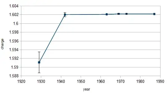

The 16th (1995) edition of Kaye and Laby includes the following progression of the accepted values for the charge of an electron. The first value "is essentially Milikan's oil drop value" and the second is "the 'X-ray grating' value". I couldn't find any more details about the actual experiments. The standard errors are often over-optimistic, indicating unexpected systematic errors; in Milikan's case this was due to an inaccurate value for the viscosity of air.
  • 1.5911 ± 0.0024 [Birge, 1929]
  • 1.60203 ± 0.00050 [Birge, 1942]
  • 1.60210 ± 0.00002 [Dummond and Cohen, 1963]
  • 1.602192 ± 0.000007 [Taylor et al, 1969]
  • 1.6021892 ± 0.0000046 [Cohen and Taylor, 1973]
  • 1.6021773 ± 0.00000049 [Cohen and Taylor, 1987]
Interestingly, this doesn't really seem to bear out Feynmann's assertion. However, it would be useful to see the progression of values between 1929 and 1942: e.g. from K&L 8th edition (1936).
