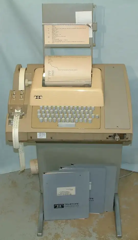

The teletype itself predates electronic computers, mechanical engineer Charles Krum filed patents for "typebar page printer"in 1903, and for "type wheel printing telegraph machine" in 1904, both based on the 1902 idea of electrical engineer Pearne. In 1906 Krum's son Howard developed the start-stop synchronizing method for code telegraph systems, which made possible the practical teleprinter. In 1908 a company eventually called Teletype Corporation was founded to mass produce the devices. Here is what ASR-33 Teletype (1963), used to interact with time-sharing IBM mainframes, looks like: enter image description here
