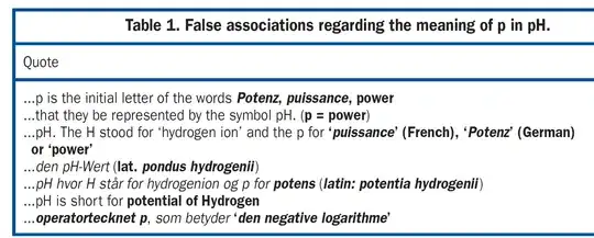

Your question requires a lot of historical background of late 1890s and early 1900s. I requested a couple of articles from different libraries. Basically, it will be best to dispel the common myth that "p" means anything from a certain European language. It does not. Later authors developed this association. At least Sorenson never used p for power or the German Potenz and there are many more stories as shown in the Table. An interested reader should consult Nørby, Jens G. "The origin and the meaning of the little p in pH." Trends in Biochemical Sciences 25.1 (2000): 36-37 for actual excerpts and other common stories associated with the letter p. His father worked with Sorenson. See this table for example from Nørby:

Now accepting the definition that pH represented a negative logarithm (of base 10) of hydrogen ion concentration, the invention of pH concept is merely a matter of convenience. Even in the early 1900's, chemists were interested in measuring the concentration of hydrogen ions by indicators. Then it must be naturally convenient to invent a scale of hydrogen ion concentration because one can vary the concentration of "hydrogen" over several orders of magnitude in water.
I do not exactly know when the letter p became an operator of of -log, but currently it is used as such.
