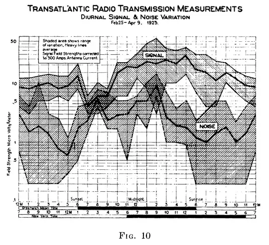

"Signal to Noise" can be traced to 1923 article, by Arnold, H. D., & Espenschied, L. (1923). Transatlantic Radio Telephony 1. Bell System Technical Journal, 2(4), 116-144.
Ratio of Signal to Noise Strength; Words Received. The noise curve of Fig. 9 and that of Fig. 10 can, therefore, be read as "The strength of the signal tone which can just be heard through the noise." It can, therefore, be directly compared with the signal curve itself and the difference between the two curves is a measure of the level of the actual signal strength above that which would just permit of the signals being heard. Actually, the difference between the two curves, as shown in the figures, is proportional to the ratio of the signal to the noise strength, because the curves are plotted to a logarithmic scale.
Figure 10
