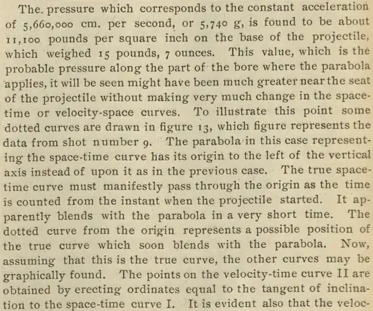

Here's an 1896 reference
"Experimental determination of the motion of projectiles inside the bore of a gun with the polarizing photo-chronograph" by Crehore, Albert and Squier, George, p. 348
https://archive.org/details/1896Experimental_photo_chronograph-BP34-6/page/348/mode/2up
The pressure which corresponds to the constant acceleration
This value, which is the probable pressure along the part of the bore where the parabola applies, it will be seen might have been much greater near the seat of the projectile without making very much change in the space-time or velocity-space curves.
The parabola in this case representing the space-time curve has its origin to the left of the vertical axis instead of upon it as in the previous case. The true space-time curve must manifestly pass through the origin as the time is counted from the instant when the projectile started.
The points on the velocity-time curve II are obtained by erecting ordinates equal to the tangent of inclination to the space-time curve I.

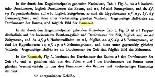

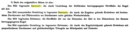

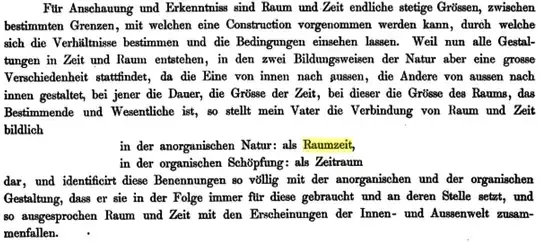

Using a search on Google Books ( https://books.google.com/ ) for "Raumzeit" (no hyphen, but include the quotes in the search), restricted to 19th century (an option of Tools, in the upper right), here are some uses of "Raumzeit".
https://www.google.com/search?q=%22raumzeit%22&tbm=bks&source=lnt&tbs=cdr:1,cd_min:1800,cd_max:1899
I'll just include screenshots...
Sorry I can't easily transcribe and proofread the German text.
I'll leave it to others to interpret the use of the term in these contexts.
(1861) Friedrich Gottlob Röber
"Elementar-Beiträge zu Bestimmung des Naturgesetzes der Gestaltung und des Widerstandes, und Anwendung dieser Beiträge auf Natur und alte Kunstgestaltung"
p15: enter image description here
p18-19: enter image description here
enter image description here enter image description here enter image description here

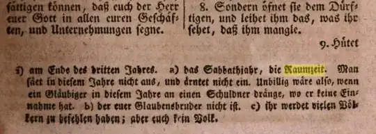

(1803) Biblia sacra oder die heilige Schrift des alten und neuen Testamentes, Volume 1
p 299 (footnote): enter image description here
By changing the range to 1700-1800, this came up... presumably an earlier version of the 1803 one.
(1786) “Die” heilige Schrift des alten (und neuen) Testamentes ... neuerdings übers. von Heinrich Braun - Christian Friedrich Wappler, 1786
p.299 enter image description here
robphy
  • 231
    As you mention you can't really transcribe the text: the first is a, to me, very weird use of Raumzeit/Zeitraum, almost like the terms were defined from scratch for some mathematical construction in that book. I have never heard or seen anything like it - it does not seem to have left a mark on physics or maths. The second describes the "Sabbatjahr" or "sabbatical" https://en.wikipedia.org/wiki/Sabbatical, and here also, at least in modern German, the term "Raumzeit" is not used in any context of this, as far as I know (in Germany, we simply say "Sabbatical" oder "Auszeit", not "Raumzeit"). – AnoE Apr 17 '23 at 07:17
    "Zeitraum", while literally "time-space" in modern German simply means "time interval" and has no connotation with "space" at all, neither in everyday language nor physics. – AnoE Apr 17 '23 at 07:18
    I was not aware that "Raumzeit" was used as a synonym for "Sabbatjahr" - a nice find! But this usage must have been obsolete for quite a while. The authoritative German dictionary by the Grimm brothers from 1854 does list "Sabbatjahr" but not "Raumzeit". If I had to speculate on the etymology, I'd say "Raumzeit" in this old agricultural sense refers to a time ("Zeit") where you leave room ("Raum") for anything to grow on the fields (no sowing and harvesting as stated in the footnotes of the bible texts). – Tom Heinzl Apr 17 '23 at 11:59

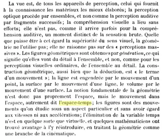

Here are 1898 references that use "l'espace-temps"
(My goal in these searches is to find in publications
the term "spacetime" or "space-time",
regardless of Minkowski's specific idea of the spacetime manifold with metric-signature isomorphic to +--- .
From my comment (in response to another comment) in my first answer,
it would be interesting if its use, in Minkowski's precise sense as a spacetime manifold for special relativity, pre-dated his "Space and Time" paper. But it is interesting to see the term in use before Minkowski, some closer to Minkowski's use and others quite distant from it. )
I found these using my Google Books search method.
"L'intuition motrice"
Georges Dubreuque
Revue Philosophique de la France Et de l'Etranger 46:253 - 292 (1898), p. 262
(copy-paste of the pdf... I didn't proofread it. You could try to paste it into Google Translate. I bolded the term.)
