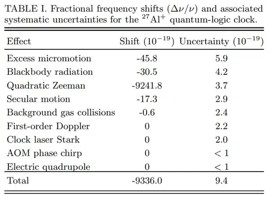

The most accurate measurement which I am aware of is of the clock transition frequency in one of the $\text{Al}^+$ quantum logic ion atomic clocks at NIST. See Brewer et. al. (2019). Here the authors interrogate a $\text{Al}^+$ ion with a laser beam and they estimate that the ratio of their uncertainty in the lasers frequency $\Delta \nu$ to the laser frequency $\nu$ is $$ \frac{\Delta \nu}{\nu} = 9.4\times 10^{-19} $$
Here is their error budget: enter image description here
We see the leading term is excess micromotion. This refers to the fact that the ion feels a force due to the RF fields used to trap it in place. This force causes the ion to oscillate, and this oscillation of the ion results in Doppler shifts of the ions actual transition frequency. The authors estimate the magnitude of this shift to be at the $-45.8 \times 10^{-19}$ level but their uncertainty is at the $5.9 \times 10^{-19}$ level, leaving it as the leading term in their error budget.
One question that jumps to my mind that I'm still researching the answer on: Why report the fractional uncertainty only without reporting that actual $\text{Al}^+$ clock transition frequency out to 19 digits? The answer is related to the fact that our current absolute frequency standards are based on $\text{Cs}$ atomic clocks which only have a fractional frequency uncertainty at the $10^{-16}$ level or so. If you want to know the absolute frequency of any oscillator you must have some chain of clock frequency comparisons eventually tying you back to $\text{Cs}$ clocks. But I believe, because the $\text{Cs}$ clocks are limited to $10^{-16}$ stability, it is not possible to know ANY absolute frequency to better than $10^{-16}$. Folks at NIST are considering a road map towards transitioning from $\text{Cs}$ based definition of the second towards a optical-clock based definition of the second so that we could all reap the benefits of a realization of the SI second with better fractional frequency stability. This is the same case that is always made to redefine the second to take advantage of more stable and accurate clocks. e.g. when we switched from quartz oscillators to atomic clocks in the first place, or from astronomical measures of time towards clock-based measures. See here for more details about the roadmap to redefine the second going forward. Right now it is not easy to make an optical atomic clock, this is a major impediment towards adopting this technology as the primary frequency reference.
