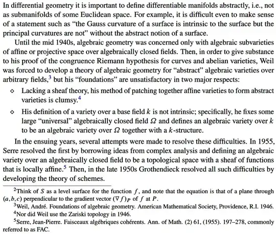

EDIT: In the introduction of his algebraic geometry book, Milne writes
It seems that to write his paper Serre was fueled by the problem of defining “abstract algebraic varieties.” When Milne says that for his definition Serre was «borrowing ideas from complex analysis,» I think he means the theory of complex analytic spaces (ringed spaces which are locally isomorphic to the zero set $A$ of a finite collection of holomorphic functions in $\mathbb{C}^n$, with $A$ equipped with the sheaf of holomorphic functions). As far as I know, the theory of complex analytic spaces is older than FAC. But I don't know if Serre was the first one to take such an approach.
