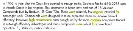

Each of the following references indicates that the "Compound steam engines" were fast because of the increased thermal efficiency.
But, the high maintenance costs brought on by the more complex equipment tended to outweigh efficiency advantages.
  1. Link1
  1. Link2
    There's a big difference between a marine VTE engine, which operates at relatively low speeds, and a Vauclain or de Glehn compound, which are high speed designs. Also, most of the early compound designs were withdrawn with the advent of superheating.The various D&H experimentals in the 1400 series were complex high-maintenance designs. It was said that they could pull well but you had to send half of the shop force out with them.
