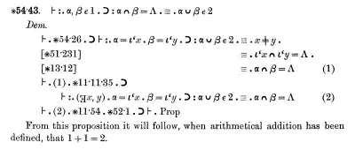

Do we say the presentation in Whitehead & Russell is not fully formal?
Gerald Edgar
  • 10,307
  • 42
  • This is potentially a long discussion, but the short version is: (1) their theorems are all pretty much trivial; (2) much of it is not in fact fully formal by modern standards, as (for example) Goedel pointed out; (3) when people checked the more formal (propositional) part of it later on with computers, they found some errors. For the present discussion, (1) is the most relevant. The main question is whether proofs of substantive theorems that research mathematicians actually care about (as opposed to "toy" theorems) can be made fully formal. – Timothy Chow Sep 10 '23 at 18:33
