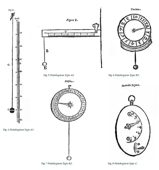

The Bulletin of the Scientific Instrument Society article Recreating the Pulsilogium of Sanctorius details a recent attempt to reconstruct the various types of pulsilogia attributed to Sanctorius and includes the following etching: Sanctorius pulsilogia

  • @pisoir By "added value" I assume that we mean "increased accuracy". The first article linked describes how Sanctorius wrote defending the accuracy of the pendulum when compared to other instruments in use at the time, so the "added value" is really in the pendulum itself. Note that the first figure (type A1) shows a pendulum independent of the measuring ruler so you're right that a pulsilogon is essentially the pendulum. The remaining four examples, where the pendulum is connected to the "ruler", would both ensure that the same pendulum and ruler where used and improve portability. – nwr Dec 18 '21 at 23:11
  • I think it would help to understand how measurements were actually taken. If I understand the article correctly, the physician changed the length of the pendulum until it was synchronised with the heartbeat, and then the length of the pendulum was the measurement value. So it was totally different from today when use a clock and count the heartbeats in a minute. The pulsilogium returned a relative value that didn't have a direct meaning but could be used to compare pulses in different patients or at different times. – Stephan Matthiesen Dec 20 '21 at 09:14
