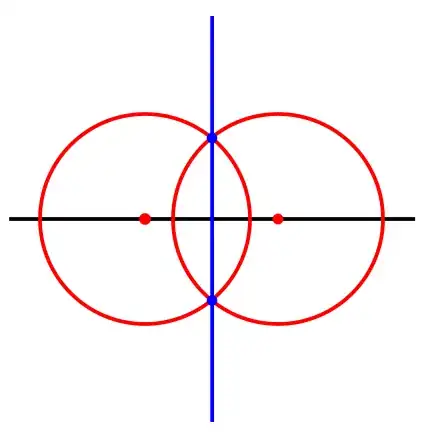

Talking about strings, you can make a square angle (on paper) with a string acting as compass. Use one end as the center of the circle and a pen in the other end.
See this image below. Already having a straight line (black line) as starting point, pick any two points (red dots) in the line. Then draw two circles (with compass, or string, or whatever you have like that) with a radius that makes them overlap (you can even use different radii!). Take the points where the circles touch (blue dots) and draw a line through them (blue line). There you have: a line that is in right angle to the original line. If you can draw that on paper, you can also carve the angle in a piece of wood (for example), comparing it to the drawing.
Draw a right angle
