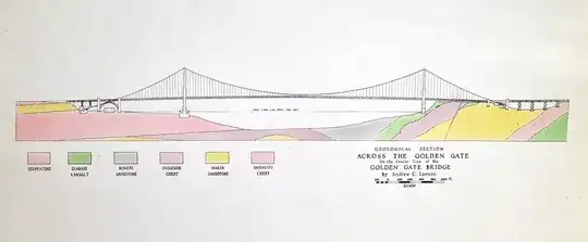

The geological model that Lawson designed is illustrated as well by one of the attachments on that site:
