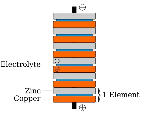

The early voltaic pile has cells consisting of a [copper||electroltye||zinc] unit, and then another, so all of the zinc->copper junctions are metal-on-metal and all of the copper->zinc junctions are metal-on-electrolyte-on-metal, as neatly illustrated by this illustration from Wikipedia:
Where did the decision come from to name the Zinc side the negative side and the copper side the positive side? Was this Volta's doing, or someone else? It's confusing for a lot of people, because we speak of "positive charge" where we now know that positive charge is really the absence of electrons.
So where does this confusion originate?
