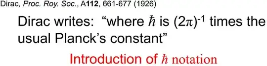

I found a presentation that claimed it was introduced in a 1926 article:
–Page 17 of "The Planck constant h and the Dirac constant ħ. Their units and their history", by Ian Mills and P. R. Bunker. [PDF]
This seems to make it clear that that article used the symbol, $`` \hbar " .$

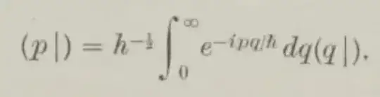

However, in checking the cited journal article, it seems to use the symbol $`` h "$ instead.
–Page 1 (printed-page 661) of "On the theory of quantum mechanics", Paul Dirac (1926-10-01). doi:10.1098/rspa.1926.0133.
This would seem to suggest that the presentation claiming that $`` \hbar "$ appeared in the 1926 article was mistaken, if the above screenshot is representative of the 1926 article.
However, as noted in one answer to my question, this article was printed around the time it became possible to use $`` \hbar " .$ So, it seems possible that some printers may've actually used $`` \hbar " ,$ as claimed in the presentation, while the screenshot above shows a different printing that fell back on $`` h " .$

  • Good catch. You should contact the presentation authors and notify them. This $h$ is no different than the normal "h" of the text. – AChem Oct 03 '19 at 19:58
  • @M.Farooq - from the second image, it seems clear to me that the $h$ there is not the same font as the rest of the text - the slant is quite apparent. But, while perhaps an italic $h$, it also is not an $\hbar$. – Jon Custer Oct 03 '19 at 20:04
  • Yes, sure it is italicized, I meant that it is not h-bar for sure. Did you notice that Dirac did not show the symbol of Planck's constant because he is using the $h$ with a different meaning? – AChem Oct 03 '19 at 20:07

Having looked through a number of quantum mechanics papers from the era, it is pretty clear that, as @M.Farooq points out, what Dirac is using in the supposed paper-of-origin is just an italic $h$, which he redefines as Plancks' constant (who originally used the $h$) divided by $2\pi$. So, that is for 1926. In 1931, Dirac is still doing the same thing (see, say, Quantised Singularities in the Electromagnetic Field).

Now, all this being said, the answer to the question in the title is a firm No - journal articles were printed and that was that. They would not be reprinted, if at all, for quite some time. Now, Dirac may well have started using $h$ in place of $h/2\pi$, which sets the stage for somebody inventing $\hbar$ to avoid the obvious confusion, but he did not actually use $\hbar$ until later.
