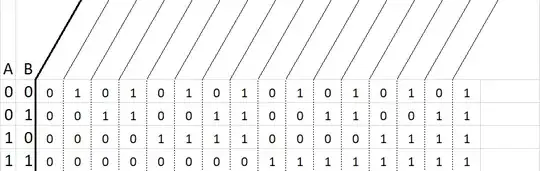

If we create a table of all of the possible truth results from two inputs (using 1 for true and 0 for false), we get:
all possible values

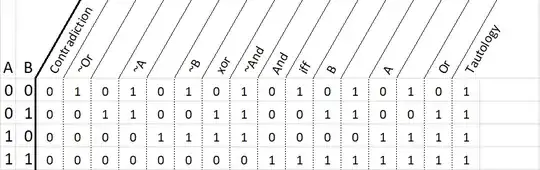

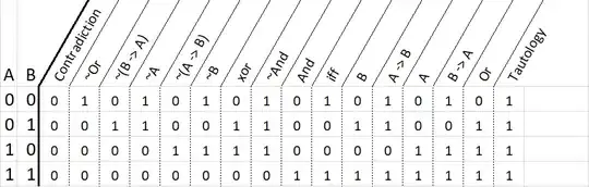

Using conjunction, exclusive and inclusive disjunction, not, and tautology/contradiction, we can label these thus:
This leaves us with the four slots in which three of the four answers are identical, and one of the two middle answers is the only different answer.
What I believe happened is that someone essentially looked at this table, realized that those four could be reduced to one asymmetric operation, and looked back to Aristotle or Philo and chose $\rightarrow$ and "implies" to fill in this relationship.
