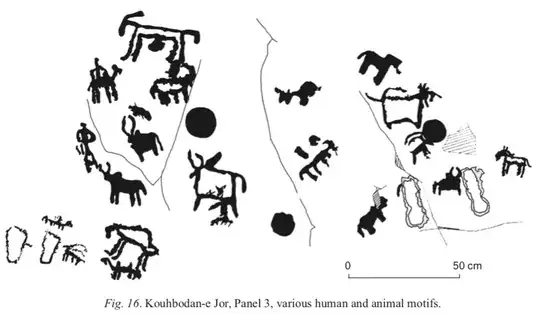

Panel 3. This is the richest panel containing different animal and anthropomorphic images. Among the animals, horses, Bactrian camels, ibexes, goats, zebus, and dogs are visible. Two human motifs are shown in this panel: one stand up in the front of a zebu and another
These motifs represent tamed domesticated horses with riders. Comparable motifs also have been previously identied at Mir Malas Cave in Luristan dated back to the Iron Age (McBurney, 1969). Such dating could be applicable to the Qasr-e Qand petroglyphs too. […]
Panel 1. This panel contains anthropomorphic and zoomorphic motifs (Fig. 14). One motif is very useful for dating of images. Here, a man is controlling the animal (probably a horse) by taking the muzzle. Some ibexes are shown in the left side of the panel beside some unidentiable creatures. The horse image is attested at an early period in the mobile art as well as on the rock art of Inner Asia and Iranian Plateau, from Altai to Baluchistan. As Francfort pointed out,
“…after having been hunted during a long period, the horse became the main mount and domestic animal very familiar to the nomadic peoples from the 1st millennium BC to our days…"
In Iran, the introduction of the domesticated horse corresponding to the Indo-Aryan peoples dates back to the Iron Age. Archaeological evidence afrms the presence of the domesticated horse in northern Iran at the end of the 2nd millennium BC. […]
— R. Shirazi & M. Soltani: "The Evidence Of Rock Art in Iranian Makran: Aps-E Goalm and Kouhbodan-E Jor Petroglyphs, Qasr-E Qand", Archaeology Ethnology & Anthropology of Eurasia 43/2 (2015) pp23–33. doi:10.1016/j.aeae.2015.09.003
