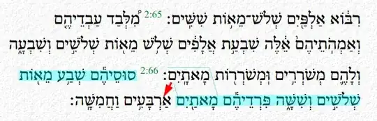

As other answers have noted, there are a number of discrepancies between the lists of Ezra 2 and Nehemiah 7 which are, largely, duplicate passages.
In the case of Ezra 2:65 and Nehemiah 7:67, there is a specific textual circumstance to explain the present text. At some very early point in Nehemiah's transmission, a scribe's eye has jumped from the "200" of verse 67, to the "200" of verse 68. Consider the equivalent text from Ezra 2:
Ezra-adapted
Notice the last word of 2:65, and how it is repeated later in 2:66 (indicated with the thin blue lines in that image), from מאתים to מאתים. For Nehemiah, the scribe's eye has followed the red arrow, resulting the omission of the text highlighted in blue, leaving a text reading "245". The technical term for this scribal mistake is "parablepsis".
Some Hebrew manuscripts and ancient translators were aware that there was missing material in Nehemiah 7, so added in the "missing" verse, but without correcting the mistaken "245" back to "200".
Note that most English versions (there are three in the example at that link) include a textual note on Nehemiah 7:68 to point out that it is present only in some Hebrew manuscripts and ancient versions.

  • Do you happen to know when the ancient manuscripts standardised on the 'modern variant' in this case? – LаngLаngС Jun 05 '18 at 15:13
    @LangLangC I don't think the ancient versions standardized -- I think in Greek Alexandrinus and the Lucianic ms family have it -- and in the Hebrew manuscript tradition "some" (Latin nonn) manuscripts (Ginsburg's Introduction to the Masoretico-critical Edition of the Hebrew Bible lists 14 mss with some notation about this). The textual history of Ezra/Nehemiah/Esdras is complicated, but it seems clear that the combined text was already known to 1 Esdras. Hope that helps. – Dɑvïd Jun 05 '18 at 15:44
    @RevelationLad "... since they do in fact include the "missing text" (correctly) in the next verse." No, he doesn't. Later scribes who knew the parallel text added it. This is a familiar feature of ancient scribal practice. It would be worth reading through Emanuel Tov's basic article on text criticism of the Hebrew Bible, where this situation is described. See also the "publications" page of his website for much more. – Dɑvïd Jun 05 '18 at 17:25
