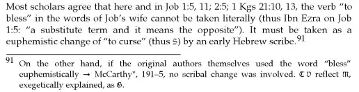

@Joseph's reference document (positing this statement as "euphemism"; mentioned in his comment above) is most compelling to me. Here are some similar suggestions from scholarly commentaries:
From John Hartley, NICOT (p. 65, n.7):
The word translated "curse", barak (also in 2:5. 9), which usually means "bless," is used euphemistically. Many consider it a scribal change for an original qillelu (which Targ. reads here), but there is no reason why this euphemistic style may not have been original.
From Tremper Longman III, Job, Baker (p. 81):
The word translated "curse" here is the comon word for "bless" (brk) but is used as a euphemism in order to keep the usual word for "curse" distant from "God." In this way, the storyteller is showing the same kind of religious fastidiousness that Job himself shows.
And from Emanuel Tov, Textual Criticism of the Hebrew Bible (p: 251):
Tov quotation
