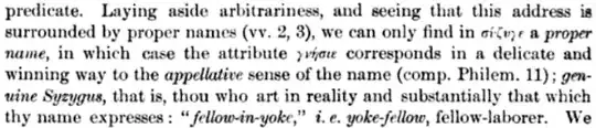

In his commentary on Phil. 4:13, Heinrich August Wilhelm Meyer wrote,9
Meyer. p. 161. Phil. 4:3.
If the apostle Paul would have modified σύζυγε by γνησία, which is declined in the feminine gender (whether vocative or nominative), then there would have been a basis for the assertion that σύζυγε is referring to a wife.
Contrary to my assertion that σύζυγε is not referring to a name, Meyer also writes,10
Meyer. p. 162. Phil. 4:3.

  • Excellent, I thought "wife" couldn't be ruled out, but wasn't completely sure since no commentary seems to even mention the possibility... I agree that the name interpretation is unlikely because of the adjective. For it to work, Paul would have to be making a pun on the name and since the name is unattested making the assumption of word play seems to folly to me. – ThaddeusB Oct 29 '15 at 14:15
  • As I mentioned in my answer, in this passage σύζυγος cannot, from a purely grammatical point of view, mean "wife". – fdb Oct 30 '15 at 13:04
It is correct to say that σύζυγος (literally “yoke-mate, one of a pair”) can be masculine or feminine, and that it is very often used to mean “wife” in classical and post-classical Greek. But in this passage it is modified by the adjective γνήσιε, which is unmistakeably masculine singular vocative. Thus, “wife” is not possible here.
