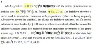

First, Gesenius (2003) provides the following for the verb דָּגָה, and he describes how the etymology of this verb relates to the meaning of "fish" in the collective sense.
Please click to enlarge.
Second, Gesenius (1910) indicates that the infinitive absolute may function as a verbal noun. He identifies examples in the Hebrew Bible where the infinitive absolute operates in tandem with the genitive.
The examples highlighted in yellow cite instances of the infinitive absolute in the hiphil stem.
Based on this approach (the infinitive absolute in the hiphil stem appearing as a verbal noun as the object of the genitive), the proposed translation of the verse would appear as follows:
