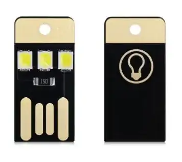

One option you have would be to use a straight circuit board with appropriate traces, if the minimalistic approach is your objective. I have what is described on Gearbest as a USB flashlight:
USB Flashlight
It is a 1.92 mm thick piece of circuit board that fits well into the USB port of my powerbank. The price for five is US$1.13 from gearbest. This is one example.
