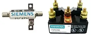

Make sure comms entrances are also grounded. Code requires that your cable TV, phone/DSL etc. lines go through a lightning arrestor on the outside of the house. These arrestors need to be very well grounded, ideally just a few feet away from a ground rod (better: two) going into the earth. A renter might be able to pester the ISP to fit quality surge suppressors on cable/phone. However, if the ground wire is thin, and has to be carried some long distance to get to the ground rod, it's almost a waste of time.

A whole-house surge suppressor. Again a renter can't install this. Siemens, Eaton etc. are big players in industrial power distribution. They make whole-house surge suppressors. These are hardwired right into the service panel. In some cases they tap the mains, otherwise you hang them off a 60A breaker.

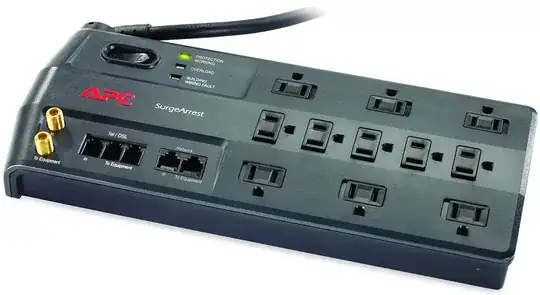

While Dan Sp. suggestion will definitely work, I feel that spending $200 on a UPS is a bit overkill for your applications. Unlike my recommendation, however, it will keep your computer running for a few minutes if the power is interrupted which would allow time for your computer to sleep (most UPS systems come with software to do this for you automatically). I would still like to recommend a significantly cheaper alternative that can protect against Ethernet/co-axial/telephone as well.
In addition, UPS systems in general, may not protect you via Ethernet, coaxial, or telephone lines, and not doing so may void your equipment protection policy should you choose to exercise it in many cases.
APC 11-Outlet Surge Protector (P11VNT3) $25.99 MSRP: $49.99
P11VNT3
This power surge protector comes with a Lifetime : $100,000 equipment protection policy. It is also featured on Lifehacker as one of the best surge protectors, and voted one by users as of the best on Co-op the Inventory. If you want to make use of the EPP, you should register the product by returning to APC the warranty card provided with the product within 10 days of purchase. In addition, Any claim under the Equipment Protection Policy must be made within 10 days of the date of alleged damage to the connected equipment.
  • 3020 Joule surge protection
  • 11 Total Power Surge Protector Outlets, 6 Outlets Block-Spaced for Larger Adapters
  • Telephone, Network (Cat-5 Ethernet Port) and Co-Axial Protection against Power Surges along Data Lines
