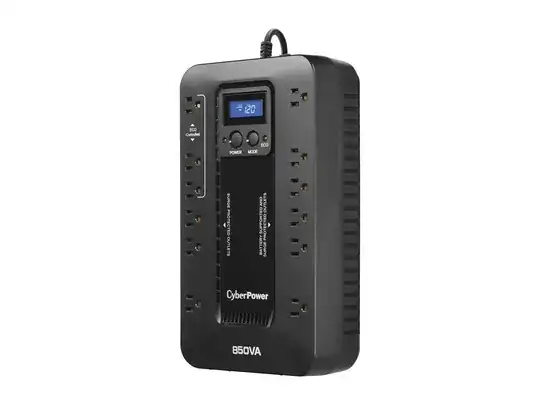

CyberPower Ecologic EC850LCD $86.95 (MSRP: $97.99)
  • 510 Watt power rating
  • 850 Volt-Amperes
  • Battery Run-time on full load: 1 minute
  • Dimensions: 12.20" x 7.00" x 3.10"
  • 7.70 lbs.
This UPS system's form factor is going to be about 2-3 power strips based on it's dimensions.

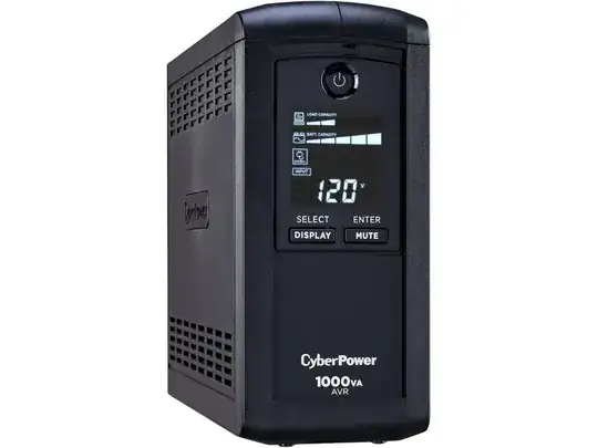

CyberPower Intelligent LCD UPS CP1000AVRLCD $109.95
  • 600 Watt power rating
  • 1000 Volt-Amperes
  • Battery Run-time on full load: 2 Minutes
  • Dimensions: 8.75" x 4.25" x 10.50"
  • 15.90 lbs.
If you have the money to spend, consider this option as this will be better equipped to handle the 600 W maximimum specification you asked for. As far as form factor, the site claims the UPS system to be about the size of a "Mini-Tower", so this one will be the size of a tiny desktop computer.
