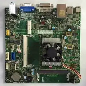

I am searching for a case that is as small as possible but can fit a Hp 110 250 Series Motherboard 762025-001 and a HDD or SDD (and maybe a case fan).
The motherboard has a build in energy supply so that there is no need for a power adapter. That is also the part that is confusing me.
I thought maybe a HTPC case or a small cube is working, but the motherboard holes are not fitting with what I found.
Any ideas for such a "special" board?

    Since OEMs like HP get their boards custom made, you will find it difficult to just screw one into any box. Their cases are made for their boards. You'll most likely have to do some custom work to make it fit with off the shelf parts. –  Jun 25 '18 at 17:09

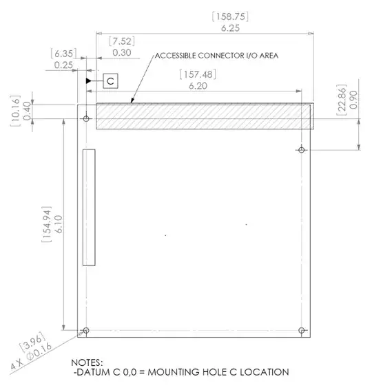

Looking at an overhead view of the motherboard, it clearly shares the same mounting holes as mITX.
So any case with mITX support–such as any one from the the 15 pages here–will work. Not sure what case you were trying that didn't work; most cases these days have support for mITX.

The great thing about building a PC is that you're free to use whatever components you'd like, including building your own! Because you're not trying to cram a lot of hardware in, if you're really bent on getting the smallest case possible, it might be worth looking at rolling your own. The off-the-shelf cases are created with the intention of being used with more "normal" motherboards and usually have to accommodate a PSU and GPU–things that aren't issues in your case. mITX is an open standard, and it doesn't take much to make a basic case.
