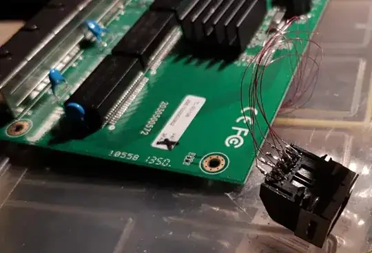

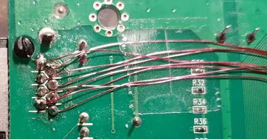

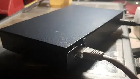

After some years with no developments on this front I had to do it myself.
TP-Link TL-SG108 with some modifications: Soldered some wires to a RJ45 connector. Cut the metal in the back to insert the port. It's not the finest way to do it, especially as there are still some corners, but at least it works.
