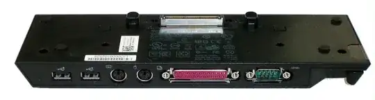

However I am working with software that is used to interface with airplanes that was designed with MSDOS 6.22 and Windows 98. I have been lucky and using Dell Latitude E-Series laptops that support this legacy dock...
Legacy E-Dock
I am looking into updating these laptops and it does not appear that newer models have a similar legacy dock. So USB would be the easier route to go but I need the replicator to present the ports as true physical ports to the OS so that they can be passed to virtual machines.
