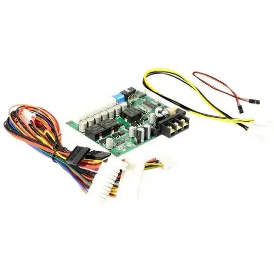

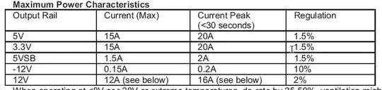

Here is 1 option: (250w) peak (300w) http://www.mini-box.com/M4-ATX?sc=8&category=981 When operating at constant 160 watts or more forced ventilation might be required.
PSU chart 250w option This picture seems to show 2 sata and 1 molex.

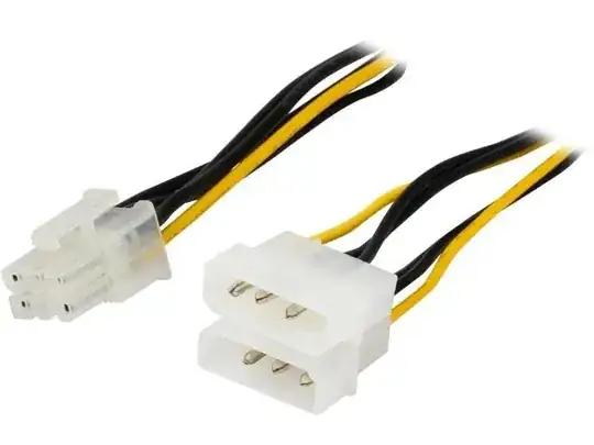

molex to 6pin https://www.newegg.com/Product/Product.aspx?Item=N82E16812423173&ignorebbr=1&nm_mc=KNC-GoogleAdwords-PC&cm_mmc=KNC-GoogleAdwords-PC--pla--Cables+-+Internal+Power+Cables-_-N82E16812423173&gclid=CjwKEAjw1PPJBRDq9dGHivbXmhcSJAATZd_B-pm9o4gStz3wqfXlWnmmOzv0yjspZ5CSOi-aS7ptEBoChGbw_wcB&gclsrc=aw.ds
http://www.add2psu.com/ Turn 2nd PSU on
Also some Y adapters.

  • So you (or this adapter cable you linked?) are saying I can just drop the sense line which the PCI-E spec asks for (as in "require"). Could you please confirm that you know that this is okay? I wouldn't bet expensive hardware on some random adapter-producer following best practices. Also, I really meant the "peak" in "Peak power 300W", so I won't need two PSUs. :) But good point about using wire of sufficient cross section. – Nobody Jul 01 '17 at 17:52
  • The diagram I found indicated that only the 8 pin version has sensing pins. I don't know what your connecting via 6 pin pcie but assuming its a video card then 75w from the mobo and 75w from the 6 pin =150w max of your budget. Note the document says forced ventilation required at 160w or more. I would get a volt meter and monitor the voltage for several hours to make sure heat build up isn't lowering the PSU performance. I am guessing this is for a car PC, and if so then if the car gets 160 degrees on a hot summer day you could have issues and need 2 PSU. – cybernard Jul 02 '17 at 17:36
