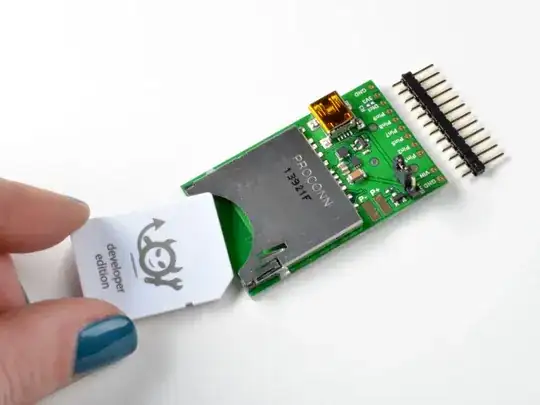

What about this little guy Electric Imp WiFi SD Card Microcontroller enter image description here
Narzan Q.
  • 234
  • The arduino (nano) is there mostly for its availability and number of available i/o pins but ultimately that is not my main concern. I'm already bypassing the linear regulator and could remove status lights and add sleep cycles to the code but it wouldn't make too much of a difference, since right now the wireless is about 70% of my power consumption. The electric imp needs to be connected to the internet at all times, if I understood it correctly. That's sadly not an option for me.. but thanks for the idea. – suborbital Feb 26 '17 at 12:53
