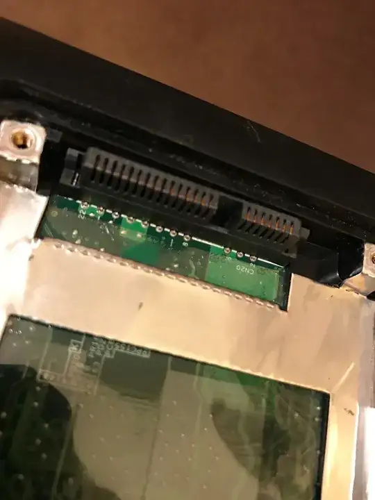

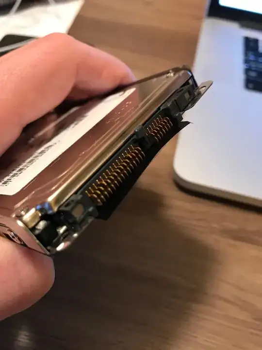

Holding the hard drive.
FemalePiece
Picture of the female piece. This is what I pulled the hard drive out of.

    Also, knowing HP and how they loved to mess with the consumer a lot and still do I wouldn't be surprised if the simple explanation was that they simply removed the standard SATA connector, leaving those comb things, and physically mated the connector to the laptop housing.....to facilitate, well, buying upgrades directly from HP. – NZKshatriya Jan 03 '17 at 00:50
  • HP Pavillion DV6000 Notebook – JParks Jan 03 '17 at 01:33

It turns out that the correct connection is/was always there. There was an adapter fitted over the SATA connector, for use with HPs internal connector.
Am re-posting as an answer in order for others to find more easily.

  • Yes, this is completely correct. The black piece with metal fins popped right off to reveal the SATA connection, which I then used something similar to what ArtOfCode posted. – JParks Jan 03 '17 at 19:26

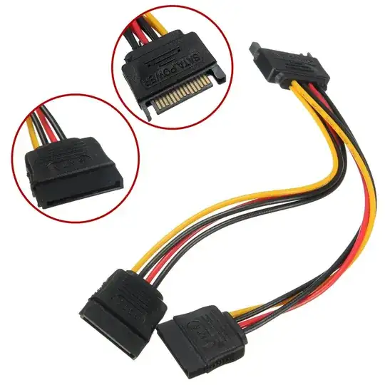

The technical document (page 3-10, which is the tenth page of that PDF) for this drive says it's a standard SATA connector; 15 power pins P1-15 and 7 signal pins S1-7. For this, you'd need a standard double SATA signal/power connector; something like this, perhaps.

The connectors in this image don't match up with the images you posted of your own drive. As NZKShatriya mentioned in a comment, I suspect that HP have modified the connector on the drive so that you are forced to use their products.

  • [This article]{http://www.dslreports.com/forum/r23090159-hard-drive-HP-Pavilion-laptop-bizare-SATA-disk-resolved} may also be of some assistance. Someone else has had the same issue lol. – NZKshatriya Jan 03 '17 at 01:40
  • Yes, thank you! That link was perfect. The weird connector just popped right off to reveal the typical SATA. I plugged it right in and discovered the hard drive is clicking! Yea, on to the next problem – JParks Jan 03 '17 at 02:45
