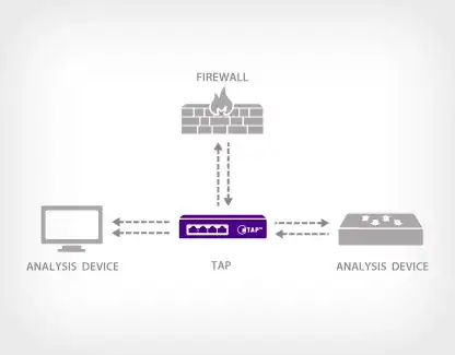

1. Network switch TAP port
On a switch, the read-only port is often called a "TAP" port...
https://observer.viavisolutions.com/includes/popups/taps/tap-vs-span.php
...although different vendors have different names.
This will pass you all the data that goes bettwen the two devices, but the switch essentially reads the incomming packets and then retransmitts them out the TAP port, so the data is buffered and error checked by the switch. You may not see some kinds of packets (like runts or bad CRC), and the timing of the packets will be altered because of the buffering.

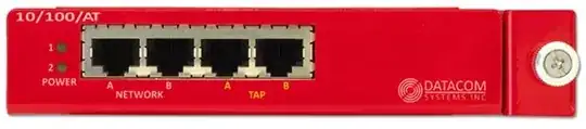

2. Dedicated tap hardware
These are expensive, but typically give you lower level access to the data. This is good if, say, you need exact timestamps for the packets which are not available on a switch TAP port becuase the packets are buffered.
http://datacomsystems.com/products/network-taps

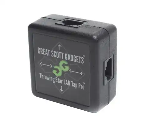

3. Passive hardware tap
If you can get both devices to run at 10Base-T speeds, you can use a passive tap like this one...
enter image description here http://hackerwarehouse.com/product/lan-tap-pro/?gclid=COGQ7Y3yqtACFdRMDQodYH4CKg
They are also not hard to make yourself if you have the right tools. A passive tap can show you even media level problems which don't usually show up on the higher level taps.
