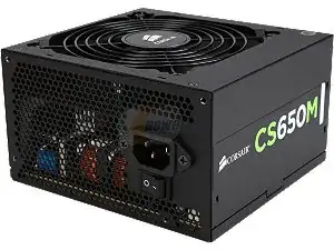

If your heart is set on modular Corsair, this refurbished 650M is only $59.99
enter image description here newegg.com
