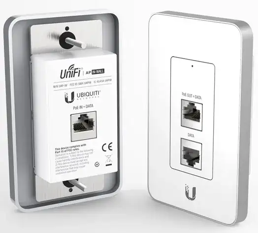

Since you like Ubiquiti (I love 'em) why not use their "In Wall" WiFi Access Point?
What I like about this solution is that it does exactly what you are looking to do all in one box:
  • Wifi Access Point
  • PoE & Data Passthrough port for a VoIP phone, camera, etc.
  • Standard Data port
The best part is, it goes into a standard wall or surface mount jack for a nice clean install.

  • It is cool, but it's just POE pass-through, not a POE injector. It would still need to be connected to a POE injector or switch. – browly Oct 09 '16 at 02:30
  • According to the documentation, this can only receive power from the UniFi switch, so it's not practical for a home user. – browly Oct 10 '16 at 22:17
  • @browly - You can use this with any POE switch. – Digital Boffin Oct 10 '16 at 22:32
  • According to the UBNT forum, the UAP-IW supports 802.3af alternative A, but not 802.3af alternative B, which is probably the reason for the footnote in the document I linked to. But you are correct that it will work with most 802.3af devices, so I retract my earlier comment. – browly Oct 10 '16 at 23:08

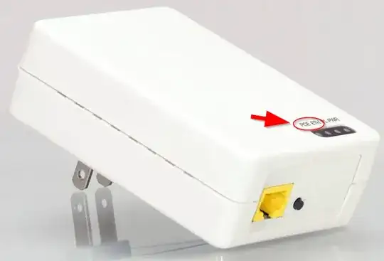

The lowest-clutter solution to connect the phone to the network and provide PoE is a Powerline Ethernet Bridge with PoE Injector, such as the Comtrend Powergrid 9141s-poe Powerline Network Adapter or the COPS-928-POE, available on eBay.
COP-Systems COPS-928-POE connects to a Powerline network and outputs PoE in one unit
Low clutter: the only item close to the phone is Powerline adapter. The phone connects directly to the Powerline adapter, which outputs 802.3af, so no need for a separate PoE injector. The only cable is the Ethernet cable going from the phone to the Powerline adapter. There's not even a power cord, since the device is a wall wart.

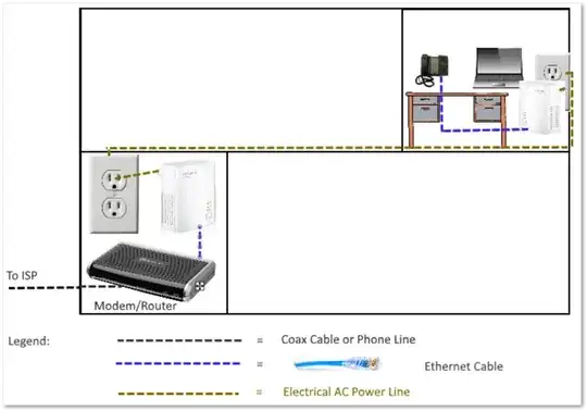

Diagram showing ISP > Cable > Modem > Ethernet cable > Powerline adapter > Outlet > Electrical Wiring > Outlet > Powerline adapter with PoE > Ethernet Cable > Phone
Easy setup: Since this solution is for a home user who will probably need to set it up himself, you want the simplest possible setup. Powerline is plug-and-play: just plug in both adapters and push the button on each one to connect them.

UPDATE (10/24/2016) I tested the COPS-928-POE paired with TP-LINK AV200 Nano. They established a link within seconds after plugging them in. COPS-928-POE powered up my phone right away, and my phone connected to the server a few seconds after the two Powerline adapters established a connection with each other. I hit the security button on both adapters to establish a secure link, and everything reconnected again within 15 seconds. There was no noticeable difference in call quality, compared to my Ethernet connection. Since they are now paired and ready to go, I will be shipping the pair to the home user, confident they will be able to get these set up fairly easily.
