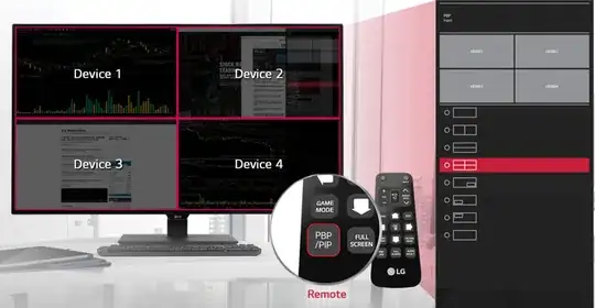

It has multiple layout options and comes with a remote. There is a video where you can see this feature in action.
LG 43UD79 4 input layouts and remote
