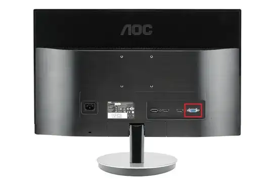

  • You got it wrong. You need VGA to HDMI converter. Your computer has VGA output then your converter should have VGA input. Check this topic: http://www.tomsguide.com/answers/id-1716596/vga-computer-hdmi-monitor.html – Pawel Gumiela Sep 30 '15 at 19:21
  • But the most important part is that this monitor has VGA input. Just use VGA to VGA cable (check my answer). – Pawel Gumiela Sep 30 '15 at 19:22

  • I just wanted to note that HDMI to VGA and VGA to HDMI are not the same. The second part is that converter wouldn't make the quality better. I'd recommend to buy a good VGA cable. Check this topic http://www.tomshardware.co.uk/forum/id-2485278/switching-vga-hdmi-converter-graphics-card-improve-quality.html – Pawel Gumiela Oct 01 '15 at 14:26
  • VGA supports 1080p as it is and if you have an opportunity to connect VGA-VGA, you won't notice any difference. – Pawel Gumiela Oct 01 '15 at 14:49

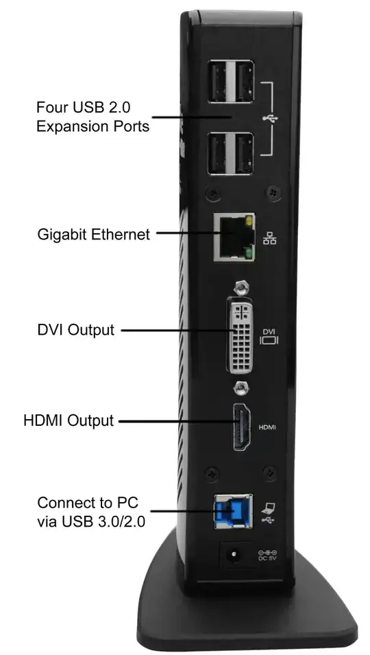

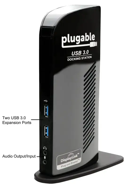

I personally use the Plugable UD-3900 USB 3.0 Universal Docking Station, I find it convenient if you have many devices to connect to your laptop. Regarding the graphics:
  • HDMI port supports resolutions up to 2560x1440* and DVI/VGA port supports display resolutions up to 2048x1152 / 1920x1200; wired Ethernet port supports 10/100/1000Mbps speeds
  • Full support for Windows 10, 8.1, 8, 7, & legacy XP systems. Surface RT, Mac OS X, and Linux/Unix are not supported. Docking station suggested for use with web and productivity software; not recommended for gaming
  • *2560x1440 output only available when using a single HDMI display. If dual displays are connected, each will be limited to a maximum resolution of 1920x1200. 2560x1440 output requires a "High Speed" HDMI cable. 2560x1440 mode operates at a 50Hz refresh rate; all lower modes support 60Hz refresh. 2560x1440 output requires current DisplayLink drivers and attached monitor must natively support 2560x1440 via HDMI input
Plugable UD-3900 USB 3.0 Universal Docking Station rear Plugable UD-3900 USB 3.0 Universal Docking Station front

  • I know that there are docking stations but they are very expensive and I need it only to solve VGA looking like HDMI on display screen. My question is on converters or something just to do that. – Mish.k.a Sep 30 '15 at 18:49

This monitor has a D-Sub input. In this case you just need a VGA-VGA cable. VGA supports 1080p as it is - you won't notice any difference since the cable is of good quality. enter image description here
