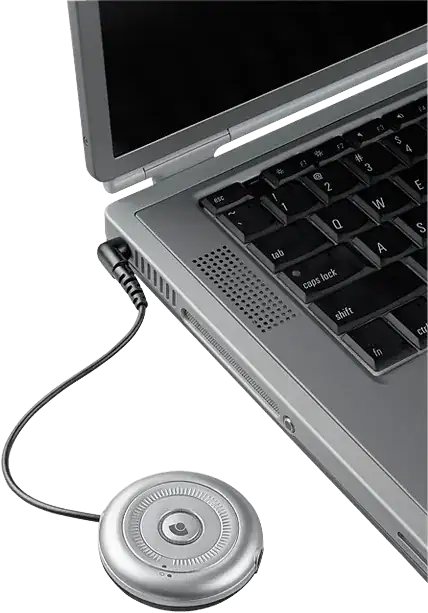

I'm seeking recommendations for a self-powered (rechargeable) Bluetooth receiver with an integrated 3.5mm male TRS plug. It's a stand-alone device which enables use of Bluetooth headphones/speakers with a device that supports a standard 3.5mm mini stereo jack.
Ideally it should:
  • use a micro USB connector for charging
  • offer some indication of battery level (visual or audible)
  • decent range
If you have experience with multiple devices your comparison is much appreciated.
The device shown below is the Plantronics 35BAA which was sold with the Plantronics Pulsar 590A, but is no longer manufactured. It relied on a proprietary charging connector (not micro USB), but was otherwise a very satisfactory device. Bonus points: Did Plantronics release a successor to this?
Plantronics 35BAA
