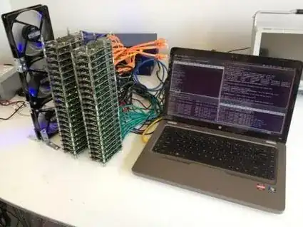

If you are willing to do a bit more work on integration with whatever you want to run, you can try a Parallella board. That gives you a 16 core RISC co processor plus a dual core main processor on a board the size of a credit card. They use very little energy and are specifically designed to be used in clusters or in parallel (hence the name) applications. As a bonus, they start at about $100 each and they run Linux. https://www.parallella.org/

    Now, THIS is something I may be interested in, though I would likely find myself building a custom case out of wood or something. Cannot just have them laying out all unprotected. – NZKshatriya Nov 01 '16 at 21:39

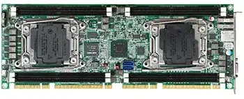

Another option you may want to look at are Industrial single board computers based on the PICMG 1.3 spec.
For example the ROBO-8122VG2R SBC supports a pair of E5-2600 series CPUs:
ROBO-8122VG2R Dual Xeon SBC
There is also the Advantech PCE-9228, which actually specifies that it supports v3 CPUs.

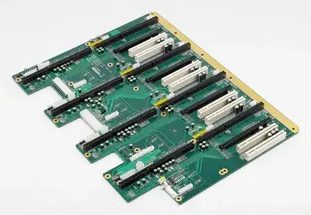

Combine these with a quad split chassis backplane and you could potentially have 8 Xeons and 4 Xeon Phi's in a single 4U 19" rack chassis.
Quad split chassis backplane
I'm not sure this would be any more compact than a cluster of 1U rack servers, but I suspect that they might be easier to work on.

  • Well, they are great, but it is more likely that I'll use Knights Landing (Xeon Phi) which is already not only in form of co-processor but in the form of CPU. 60+ cores, 240+ hardware threads. – iXCray Jul 14 '16 at 17:36
