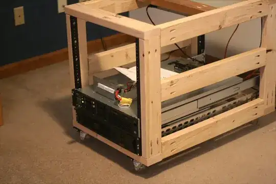

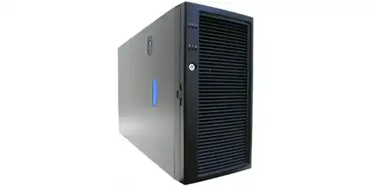

The existing case is an IntelĀ® 5U Server Chassis with dual 730 W RPS hot-swappable redundant power supplies, hot swappable fan modules, hot-swappable drive bays and more. I believe the chassis is from the IntelĀ® SC5400 Family. It was originally sold as a Gateway E-9510T Server R1 [Part #WME876246].
It has the 5U rack conversion kit, and I have a place for it in the rack. Space is not a problem.
This document appears to reference the same chassis I have (and it includes some diagrams so you can get an idea what it looks like).

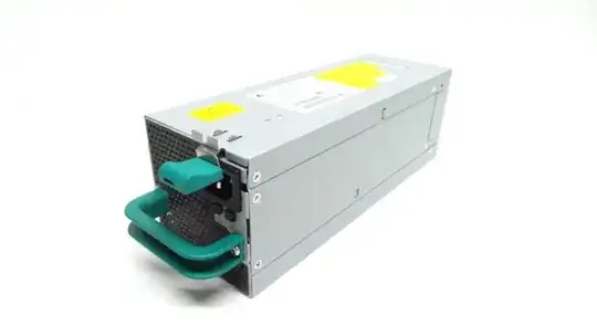

The power supplies look like this (except 730 Watt): https://www.amazon.com/dp/B00QR19214

My biggest question is whether the 730 W RPS hot-swappable redundant power supplies are worth keeping. I will be using a Super Micro X10DAL motherboard with dual Xeon E5 26XX v3 CPUs. Will these older PSU output clean enough power?
Also relevant: I have a complete spare case, which gives me 2 more PSU in case I have a failure as well as a spare of every other part I might need.
