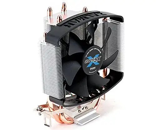

You might consider the Zalman CNPS5X PERFORMA off Amazon for $25.91. It's not too loud at 100% speed and I was able to use it to cool an i7 6700k being stress tested at 4.6Hz (I was getting about 85C - 90C) (I've also upgraded since then). All in all, it's a great cooler, installation is super easy, you literally just snap it in, you don't need to take the motherboard out.
Hope this helps :D
n.b. It supports LGA 775, not 1366.
