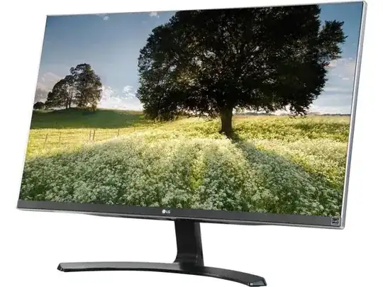

Who among us would not drool over this non-HDR 28" 4K LG monitor!!
