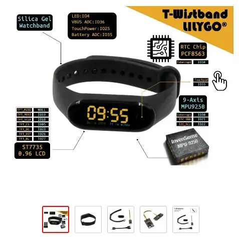

If you can live without GPS, or can solder, then I also recommend LilyGo.
They have a slim wristband, like an activity tracker for about $20:
and a wristwatch with a larger screen for about $25:
All three of these are ESP32 based, so have WiFi and BlueTooth, and are fully programmable.
