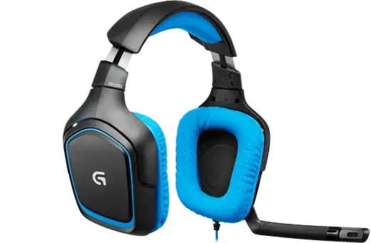

I'm going to recommend the baby brother of Adam's answer: the Logitech G430.
Logitech G430
Regular price is around $75.
  • It fits over the entire ear (and isn't circular). I can wear it for hours at a time with no discomfort.
  • 7.1 surround sound. It works very well in both games and movies.
  • Noise canceling microphone. Team mates in games mentioned that the clarity is very good (and were appreciative when I started using this headset compared to my cheap previous one).
  • The ear cups fold flat, so you can lay it flat on a desk.

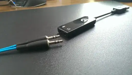

  • USB connection with on cable controls for volume adjustment and ability to mute the microphone. It is a wired headset, but the cable 7.5 feet long. This length has been fine for me. The headset actually has 3.5mm connections that plug into the USB dongle, if you wish to go that route. 3.5mm to USB dongle

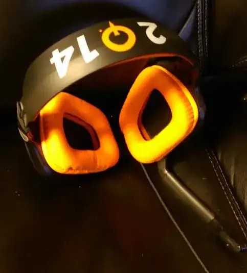

Finally, I got my set at QuakeCon 2014 and have nice orange padding vs. the blue that you get at retail.
QuakeCon 2014 G430

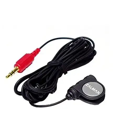

You might consider just adding a microphone to your setup (i.e. "convert" your headphones to a headset), like this lapel microphone from Zalman. That's what I've bought to use with my Sennheiser HD558's to great effect, and it costs around $9.
External Zalman lapel microphone

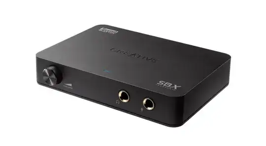

You could also purchase a USB sound system, like this Creative X-Fi external pre-amp and sound system, which you can get for around $90. I'm not an audiophile (though I enjoy good sound), and I don't think that's audiophile quality - but if you're into good sound without being an audiophile, that's probably a good setup. The upside is, you don't have to change your current headphones and you will get a better sound than other systems, in my humble opinion.
Creative X-Fi sound console

  • I've got an external amp as well I use with my headphones already, this looks like an interesting idea to just get a simple microphone! I never thought about doing it this way. – enderland Sep 18 '15 at 13:59
  • Yep. I was looking around for a while to get a good quality headset to replace an old Creative set I had, and found some forums (forget if it was Head-Fi) where they mentioned it. Then, I got some good headphones and voila! awesome "headset". You may need a splitter if your audio jack is one of those in/out mic + headphones one (like I have on my laptop), FYI. They're pretty easy to find online. – Juan Carlos Coto Sep 18 '15 at 20:10
