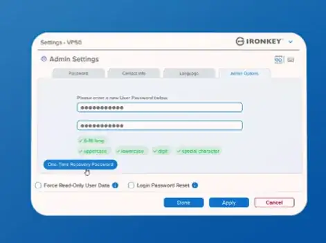

In 2023, there are many hardware encrypted USB sticks or flash drives. As an example there is this
With
  • Enterprise-grade security
  • XTS-AES 256-bit encryption
  • Available in Type-A and Type-C USB
  • USB 3.2 Gen 1
  • 8GB, 16GB, 32GB, 64GB, 128GB, 256GB
  • Up to 250MB/s read, 180MB/s write
It pops up with this
