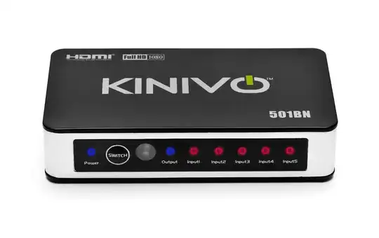

This isn't necessarily the product I'd want but it's a low-end solution for $18.28 USD: enter image description here
http://www.amazon.com/EnjoyGadgets-Switcher-Selector-Support-Switching/dp/B003AQD5W6
Some IR sender could be programmed to control this. Perhaps something like this: http://www.amazon.com/Global-Cache-IP2IR-iTach-Wired/dp/B003BFTKUC [+$92.00 USD]
There's also a 5x1 option: http://www.amazon.com/dp/B0049SCB2Y?psc=1 for $39.99 USD enter image description here
