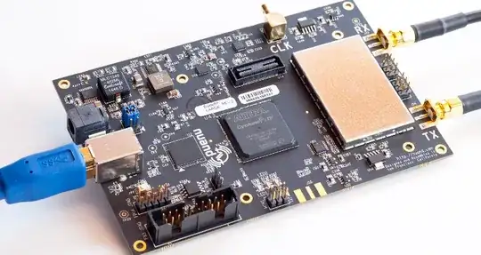

You can achieve this using an SDR (software-defined radio). It's essentially a device that can be programmed to transmit any radio signal you want:
Nuand BladeRF board
These SDR boards are known to be able to produce GPS signals:
(To configure one of those to send out GPS signals, you could use for example gps-sdr-sim, an open source Software-Defined GPS Signal Simulator.)
