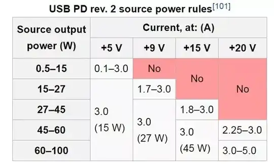

  1. The power source can have different pinout and capability depending on what they are supporting from 1A to 5A+ and 3V to 20V+

For a cable the best bet is a well know brand that has a chip in the cable connector to determine how to route the power and one that does data as well.
