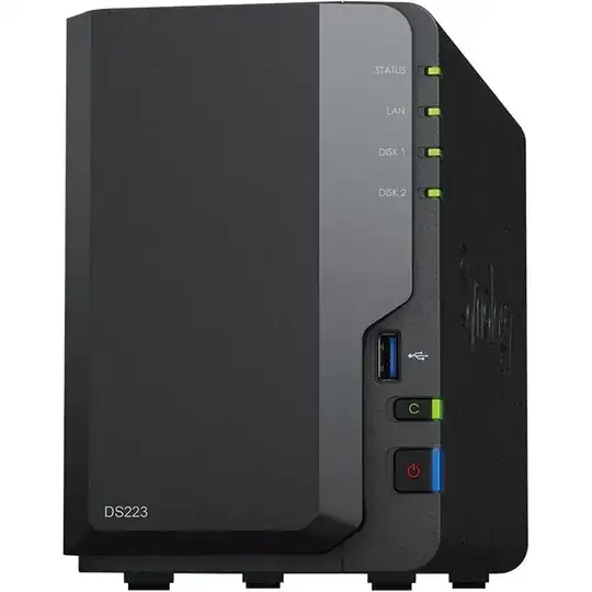

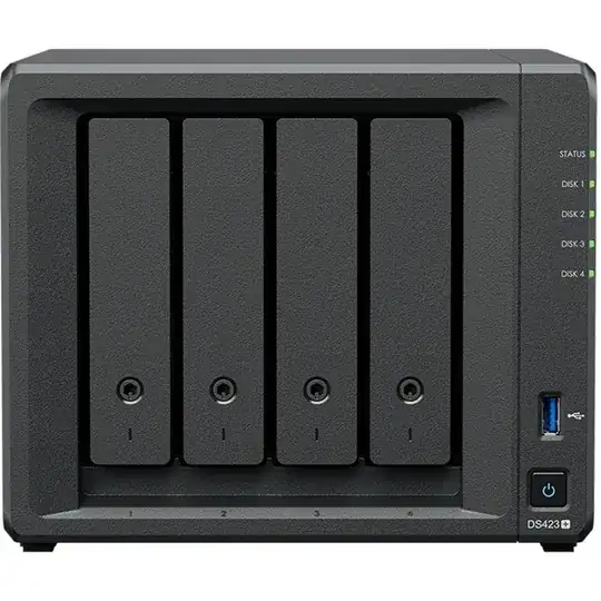

In 2024, I would recommend Synology NAS. I have had a 4 drive one at my home office and a 2 drive one at a friends place to backup the NAs onto another NAS.
  • I backup all my drives.
  • I mirror all my documents and photos. We can then access these from anywhere.
  • I also have GIT repositories on it for my source (being a developer)
  • You can do everything on a browser
  • The Apps on the NAS as well as the Apps on the mobile are crisp, clean and very functional.
These are the two I have. I am about to install an SSD on it, to speed up the access.
